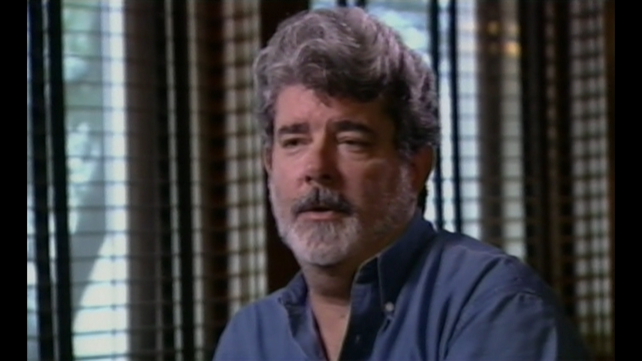

This is not a particularly sophisticated project, and indeed although it's watchable I'm not necessarily finished with it. It was basically my first shot at mucking about with AviSynth (with some advice from this forum, actually) because I couldn't see a better way of doing it.
This is the 1997 featurette ANATOMY OF A DEWBACK, about the process of doing ungodly "Special Edition" CGI modifications to the "look sir, droids" sequence in STAR WARS (1977). It was originally released in five very short (~5 min) "episodes" exclusively on the official Star Wars website (and yeah, this was 1997 so it was a really really awful 240p, 24fps RealPlayer stream) and although later released in its entirety on Blu-ray in both 2011 and 2020, they screwed it up pretty badly both times, which annoyed me enough to try to fix it up a bit.
The original 1997 web video is long since deleted, but I kept a recorded copy of the files and recently dug them out to have a look. The video appears to be 320 x 240 pixels (4:3) but this includes black letterboxing; without the letterboxing it’s more like 320 x 192 px, which is a somewhat unusual aspect ratio of 5:3. Although this is the native aspect ratio of 16 mm film, this featurette seems to have been shot on video so it’s probably more significant to note that 5:3 was used in some countries as an early “widescreen” format for a while, presumably as a compromise between theatrical 1.85:1 and 1.33:1 (a.k.a. 4:3) home video. This original version looks something like this, if you crop off the letterboxing from the top and bottom:
[Image: Wad9yEG.png]
On the 2011 Blu-ray, the featurette was for some reason encoded to display as (almost) 5:3 “widescreen” on a 4:3 television screen. The trouble is, even in 2011, those were a dying breed, and definitely aren’t anywhere near as prevalent in 2020. The result of this is that the vast majority of people will watch this on a 16:9 screen, but the “widescreen” image will not even come close to filling the display on account of being restricted by the 4:3 box. The actual image is a very rough looking 700 x 430 or so pixels, inside a 720 x 540 pixel 4:3 frame. It’s “open matte” to some degree as it hasn’t been framed correctly for this release, but it’s also skewed toward one side, with the left side not cropped enough and the right side slightly over-cropped compared to the old web video. It also appears to have been slightly squashed horizontally. That one looks like this:
