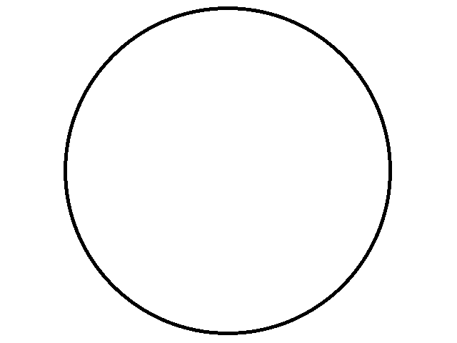

Let's assume that the active picture area in this 720 x 480 image is indeed the 704 x 480 in the middle, such that the bit we want to remove is exactly 8 pixels off the sides before resizing (as opposed to 8 off the sides after resizing). It looks like this before doing anything with it:
[Image: DVDSAR1-720x480.png]
First off, here's the result of cropping out the 8 pixels of horizontal blanking on either side first, then reshaping to 4:3:
[Image: DVDSAR4-cropthen640x480.png]

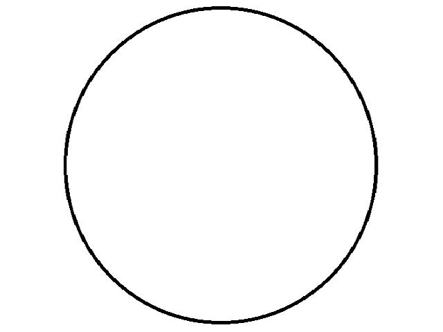

Conversely, here's what happens if you don't crop out the horizontal blanking, including it in the 4:3 frame:
[Image: DVDSAR5-nocropthen640x480.png]
