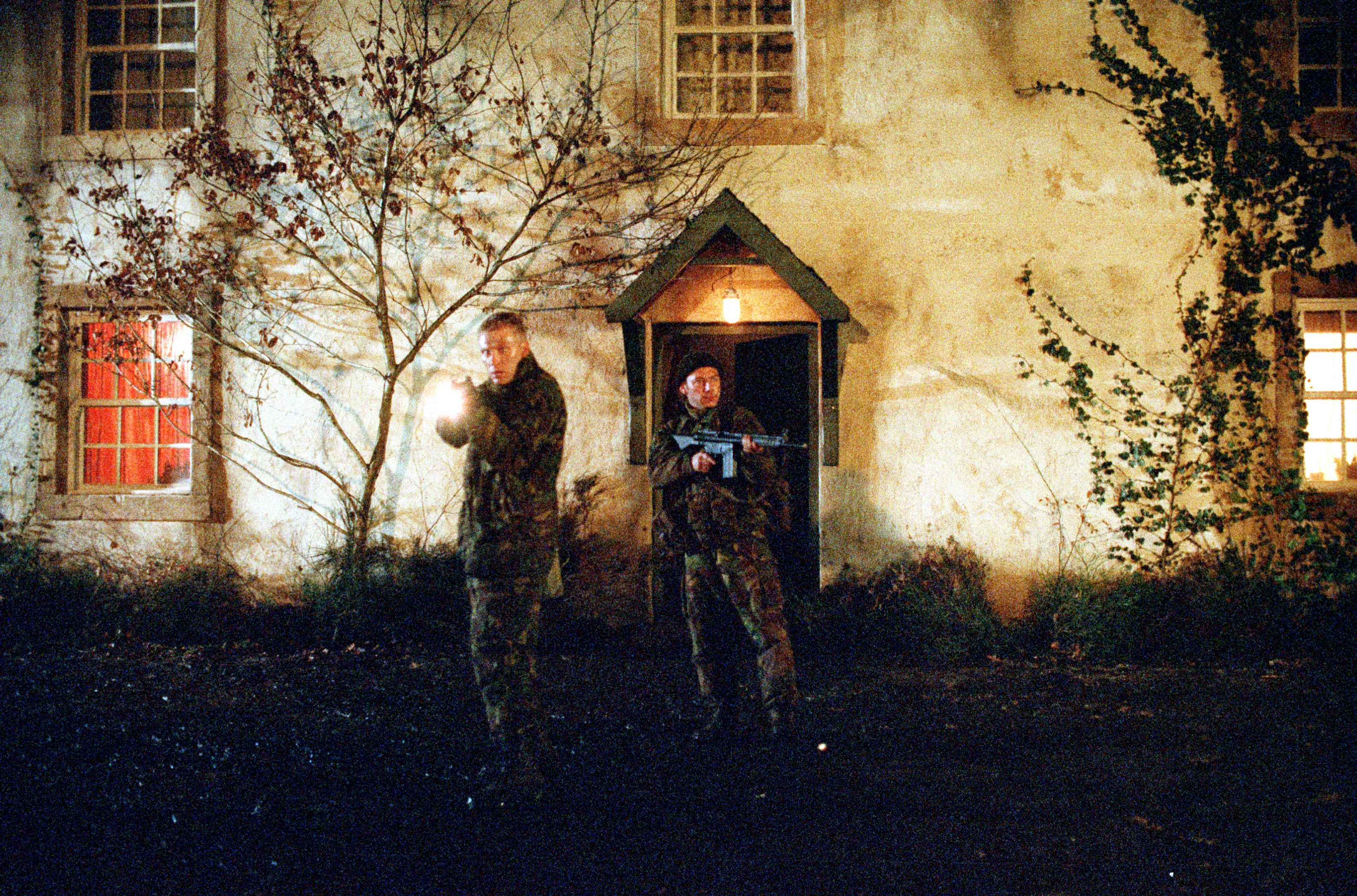

  5. The English audio has been screwed up pretty severely, with at least two moments I know of thus far where the music or some other part of the audio is completely out of sync, causing it to obscure or even completely replace dialogue. Around 00:03:25 or so, the music builds to a crescendo then stops abruptly in every other audio track (e.g. DVD, Scream Factory BD, and German 5.1 track off this release) but in the English 5.1 Koch has the music fall behind so that it's still blaring when a character speaks instead of being almost silent. There's a similar issue a few minutes later as well (as described here) where a helicopter sound is duplicated in place of an actual line of dialogue, which is subtitled but not actually present in the audio (Koch on left, Scream Factory on right):
    [Image: Dog-Soldiers-Koch-Media-00h07m44s-line-missing.png] [Image: Dog-Soldiers-Scream-Factory-00h07m46s-line-present.png]
