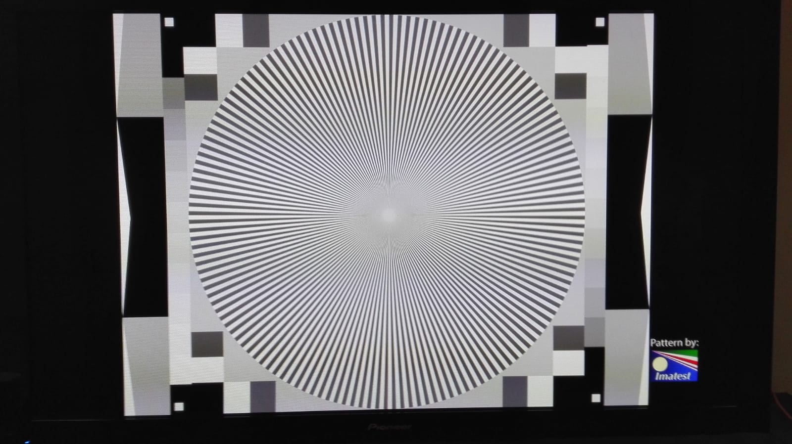

UPDATE:
I tinkered with the laptop video card settings, and got 1920x1080 displayed at 99.9% - I guess I've lost 4 or 5 pixels on the left side, but I preferred this instead of getting the whole image but 4 or 5 black pixels on the right side.
Watched Mission: Impossible II (from an old HDTV 720p recording) and it looked very very good! Took a look at some others 1080p and 576p videos, too.
  • Blacks: not inky nor deep, let's say medium blacks, still better than very dark grey available on cheap LEDs; I must watch it during the night, curious to see if blacks would be deeper
  • Brightness: sufficient, still good for SDR
  • Colors: very nice; although not (yet) properly calibrated, they seem spot on
  • Resolution: finest details were resolved very well - single hair, skin pores etc. - and diagonal lines were always perfectly resolved; sure it's not a real full-HD, but the result is very good and I bet nobody could tell it's only an HD-ready display if not using it as a normal PC monitor
  • Motion: pretty perfect; never noted judder or other motion artefacts
  • Offset view: incredible! Is it possible to watch it from any angle, and the quality remains the same!
  • Retention: zero! Unbelievable, as it was used as a videogame monitor before (and I guess quite much), still no burned in/ghost image
  • Dead pixels: none - at least, using black, white, red, blue, green fullframe images
  • Screen uniformity: perfect!
  • SD quality: difference with HD is very clear, but it's quite good, albeit soft - but I guess it's the best way to watch good analog sources like laserdisc, as upscale is "only" from 480/576 to 768, and simpler in comparison to 1080 (480 x 1.6 vs 2.25 - 576 x 4/3 vs 1.875)
  • Audio: great! Using two cheap Philips loudspeakers from 20+ years old mini stereo system, sound was crisp and powerful - its 2x18W seems to work very well... better loudspeaker are needed, though!
Well, I repeat myself like a broken record, but after have watched a whole movie, I had that sensation of "cinemaness", analogness that LEDs can't give - had not the occasion to watch a whole movie on an OLED, though...
