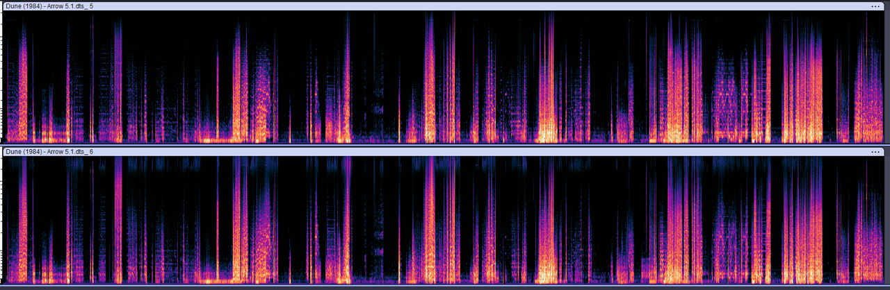

Using the same Dune example, here's the spectrogram for the remixed 5.1 surround channels.

I'm a bit new to this, how do you deduce the matrixing from the spectrogram? All I see is both channels are similar.
Take a closer look at them, you will noticed matrixed surround channels have harder cutoffs and generally "stranger" looking forms compared to a discrete track.

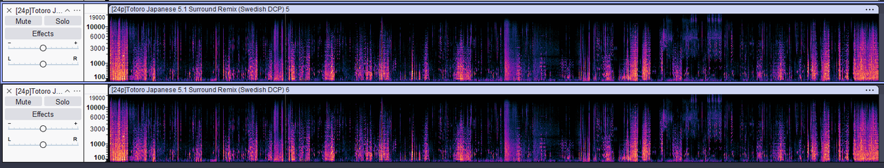

I'm sure it's not. Here an example using the recently leaked Japanese DCP PCM 5.1 for My Neighbor Totoro, a film that has never had a 5.1 JP track on any home release and was mixed in Dolby Stereo. Note how it has the same characteristics of the Dune DVD example.
[Image: imagetotoro.png]

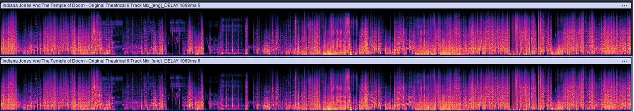

It's entirely possible they decoded it, Listening to the surround channels on their own they sound rather low quality and a little "hazy" which matches other decoded tracks I've heard but at the same time the track overall sounds higher quality than the Arrow 2.0 so perhaps they decoded it from a higher quality mag source, I have no clue to be entirely honest. I found this method from a friend who was checking the Indiana Jones DVD 5.1s (the ones that are in fact the 70mm Six-Tracks) and they have the same attributes (both in listening and spectrogram). Below is an example from Temple of Doom.
[Image: Screenshot-2026-02-25-125029.png]

But 70mm 6-track audio is not matrixed. These tracks are entirely discrete to start with. So what you're seeing on the Indiana Jones surround channels has nothing to do with matrixing or decoding.
