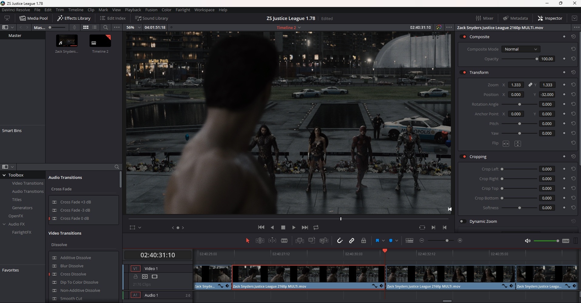

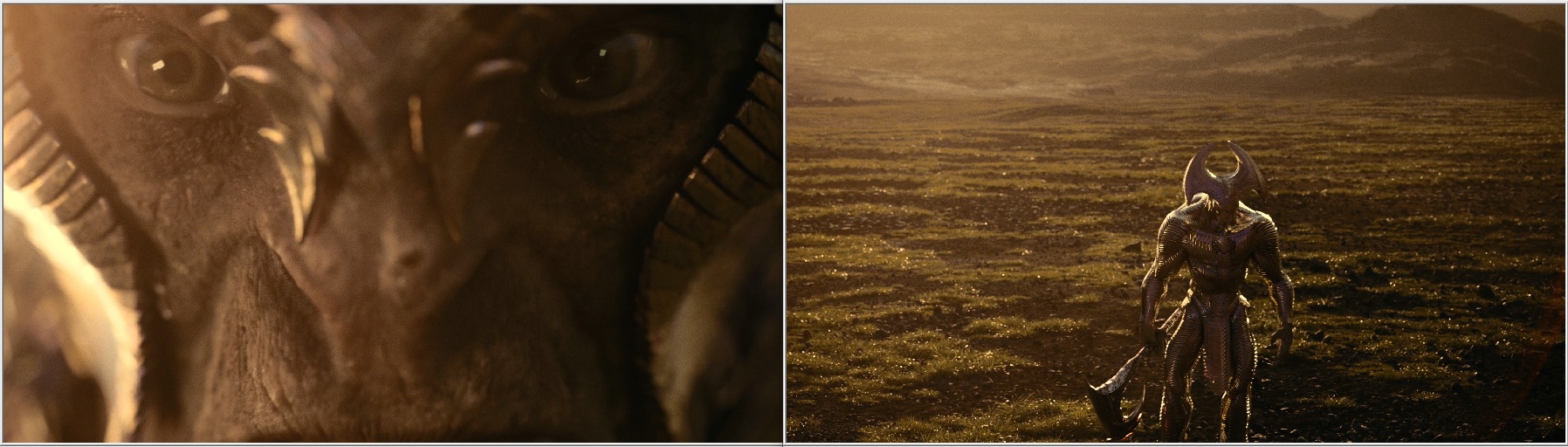

I'm currently reframing Zack Snyder's Justice League from 1.33:1 AR to 1.78:1 AR, 'cause had it been released in theaters, there's no way Warner would have agreed for a 1.33:1 wide release. It was obviously intended to end up being a 1.85:1 AR as the trailers from before the 2017 release showed, plus all the negative space on most of the full 1.33:1 AR. Only real IMAX theaters would have had it barely cropped to 1.43:1, while LIEMAX would have had it cropped to 1.90:1, so more than regular theaters and that's exactly what happened in 2017. I found it frustrating not to have the option for a full 16:9 screen, though, so I ended up doing it for more immersion into it as we no longer have 1.33:1 screens at home. Of course, I'm recomposing every single shot one by one to show what's important and to still make it look good regarding head room and stuff, showing more on the top or on the bottom part of the frame. I'm not creating in-shot bogus digital post processing camera movements as I'm not the director nor the camera operator, plus I wouldn't even know how to do such a thing even if I wanted to. I'm doing it using the UHD as source since I have to zoom in, and I'm aiming at a full HD 1080p rec.709 SDR rendering. I have glued the two parts together and removed a few seconds of black in between and cut out the information that "Justice continues on disc 2" of course. For now, I'm at 69% of the whole runtime, at this scene:

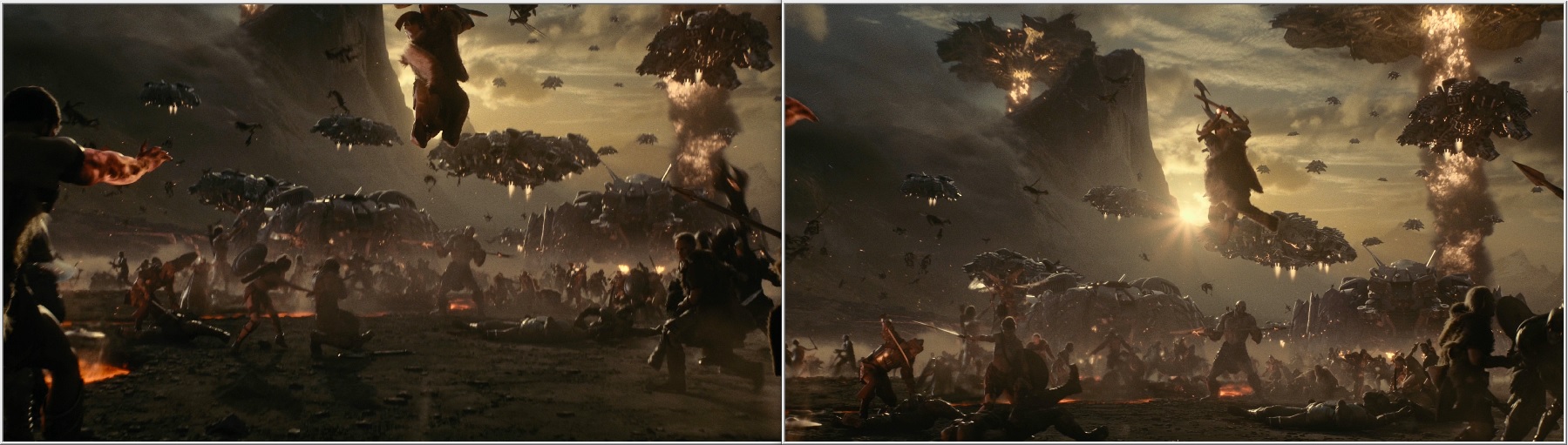

Now there is a catch, and that's where I'll need other people's input. As shown in the Youtube video below, in this scene, when Flash comes into play, several slow motion shots were vertically stretched, probably because the VFX were finished for the theatrical 1.78:1 AR or 1.85:1 AR, and thus the stretching, and a bit of cropping as well, permitted to fill the 1.33:1 AR. So my question is: should I keep it that way for the 1.78:1 AR or should I squish it back to more proper proportions? The Youtube video claims it works stretched as it's during a super speed moment that could translate into distortions. I can go along with that, except I didn't notice that on other instances of the super speed, so it's not really consistent in the whole film...

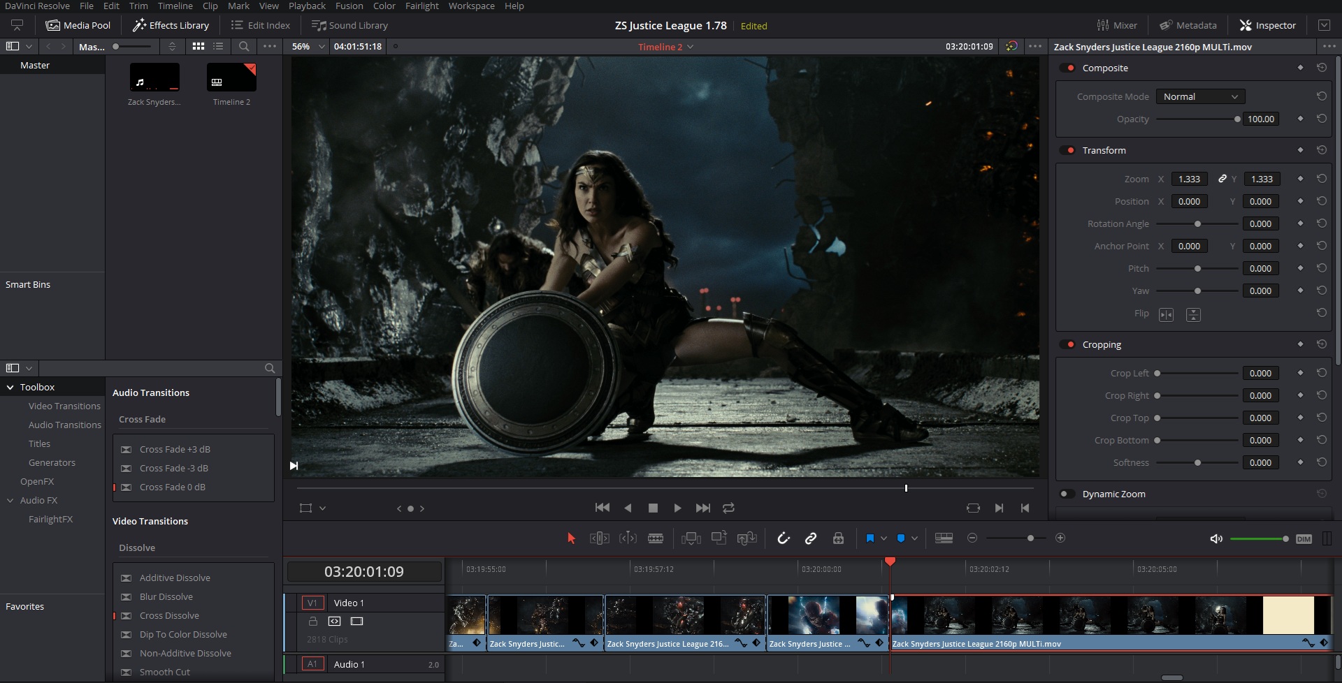

Update: I'm at almost 86%, 3 hours and 20 minutes in. I'm still wondering what I'll do with the vertically stretched shots mentionned above. Since I'm analyzing each shot one by one regarding the framing, I'll pay attention if the stretching happens again with Flash in the climax. If not, I guess I'll try and squish the stretched shots back to more proper proportions for consistency in the look of the super-speed and use the theatrical release as a guide for said proportions.
[Image: zs-jl-2.jpg]
I'm at 92%. I didn’t notice any vertical stretch in the super-speed moment in the climax, when Flash goes back in time. So, unless someone gives me a good reason to keep the distortion in the Superman-Flash face-off, I think I'll squish those shots back to more natural proportions for consistency in the look of the super-speed. It is very likely that the distortion was done to fill the 1.33:1 AR after the VFX were already made for the theatrical cut AR, and since I'm reframing to 1.78:1, I can't see any reason to not squish these shots back.

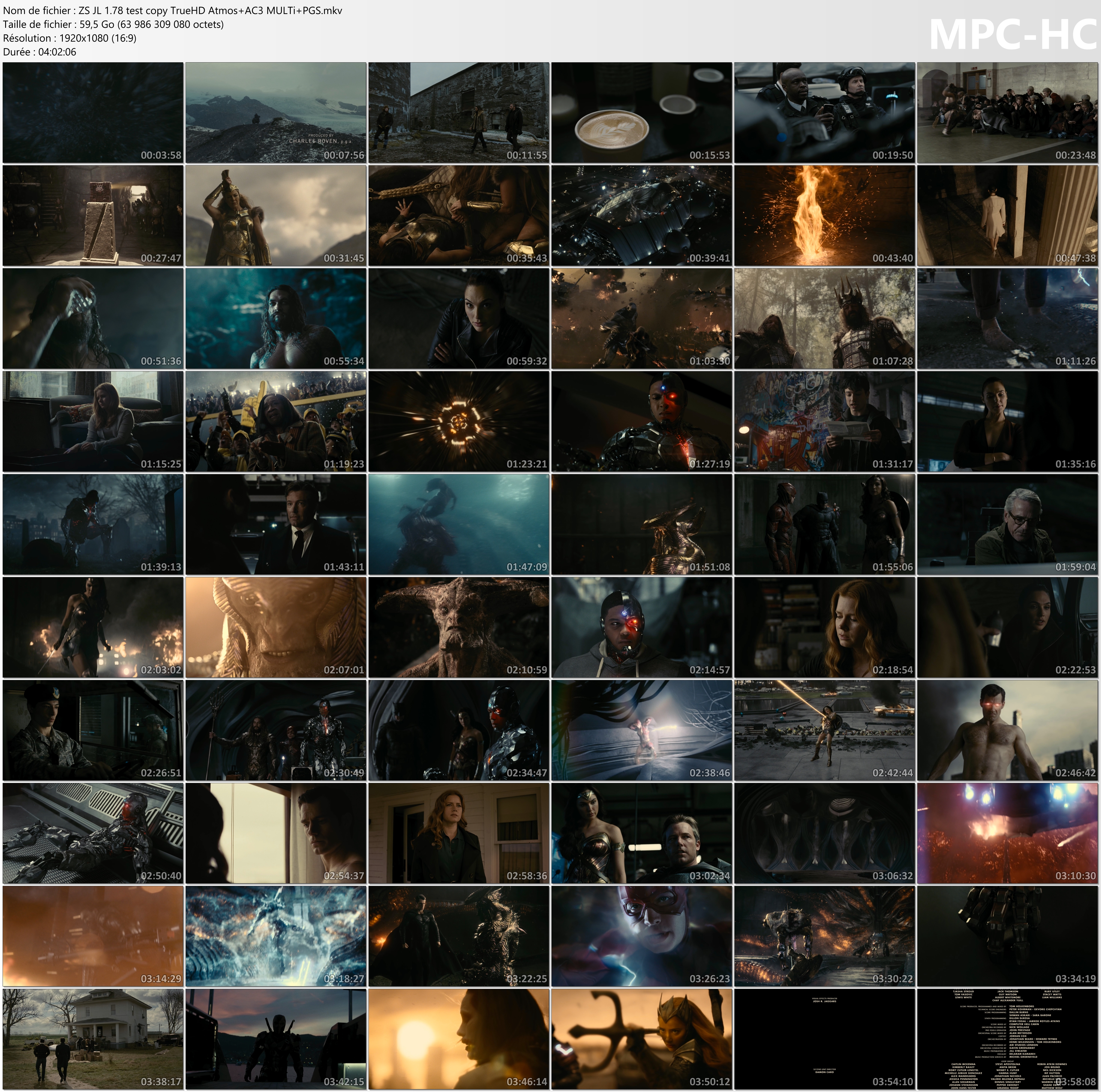

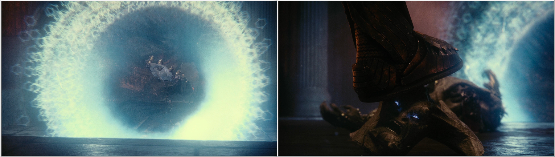

Okay, it is done. Including the squishing of the 8 shots that were stretched. Now I need to review my test copy to see if I need to adjust the framing of some shots. And I need to see if I crushed the blacks when mimicking the official Rec.709 SDR grading.
[Image: ZS-JL-1-78-test-copy-True-HD-Atmos-AC3-M...thumbs.jpg]
Thanks given by: Hitcher , Koltesian , Pineapples101 , ReconWorld
Looks like a very good release. I have a previous 1.85:1 release using the 4K HMAX version.
I was happy to watch the 1.33:1 version one time, but it was a bit of a gimmick for home viewing.
It is great that you were able to sort out the squeezed shots.
Oh, somebody already did a 1.85:1 version? Oh, well, I'm sure the choices in framing will be different anyway. Plus I made it 1.78:1 so it can be full 16:9 widescreen and still be compatible with 1.85:1 soft matting either in VLC or on some projectors.
