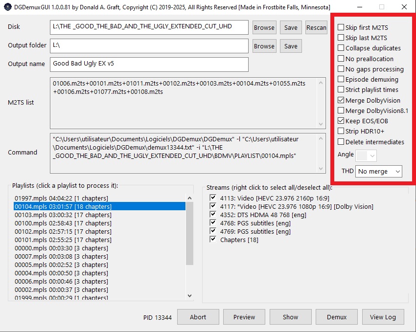

Hey, audio experts.
How do you configure DGDemux to make sure the audio is okay at junctions with a seamless branching disc?
Do you check any of those boxes on the right? Or do you leave these as is, on default configuration?
[Image: dgdemux.jpg]
I just use the defaults. I'm using the cli linux version, but I'd assume the default settings are all the same. Haven't noticed any issues with audio skipping with it like I have in the past with makemkv.
(2025-09-13, 01:13 PM)Beber Wrote: Hey, audio experts.
Let me know if that works because I had an awful time trying to rip the 181 minute version myself.
MKVToolNix GUI didn't like the audio or subtitles so I could only extract the video using it. I then had to use Handbrake on the fastest settings but with passthrough for the audio so it was untouched. Then finally MKVToolNix GUI again to merge them all back together.
