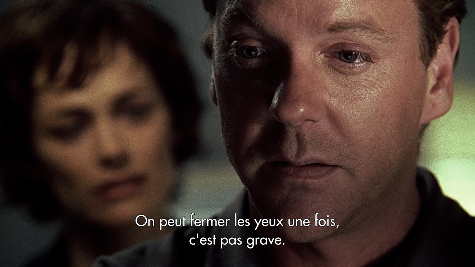

[Image: 24-s01e01-1080p-Blu-ray-AC3-PGS-mkv-snap...03-588.jpg]
And if you want the same look for HDR, you just change the color code I put in bold red above to &H00A0A0A0 just like I did for The Good, The Bad and The Ugly.
