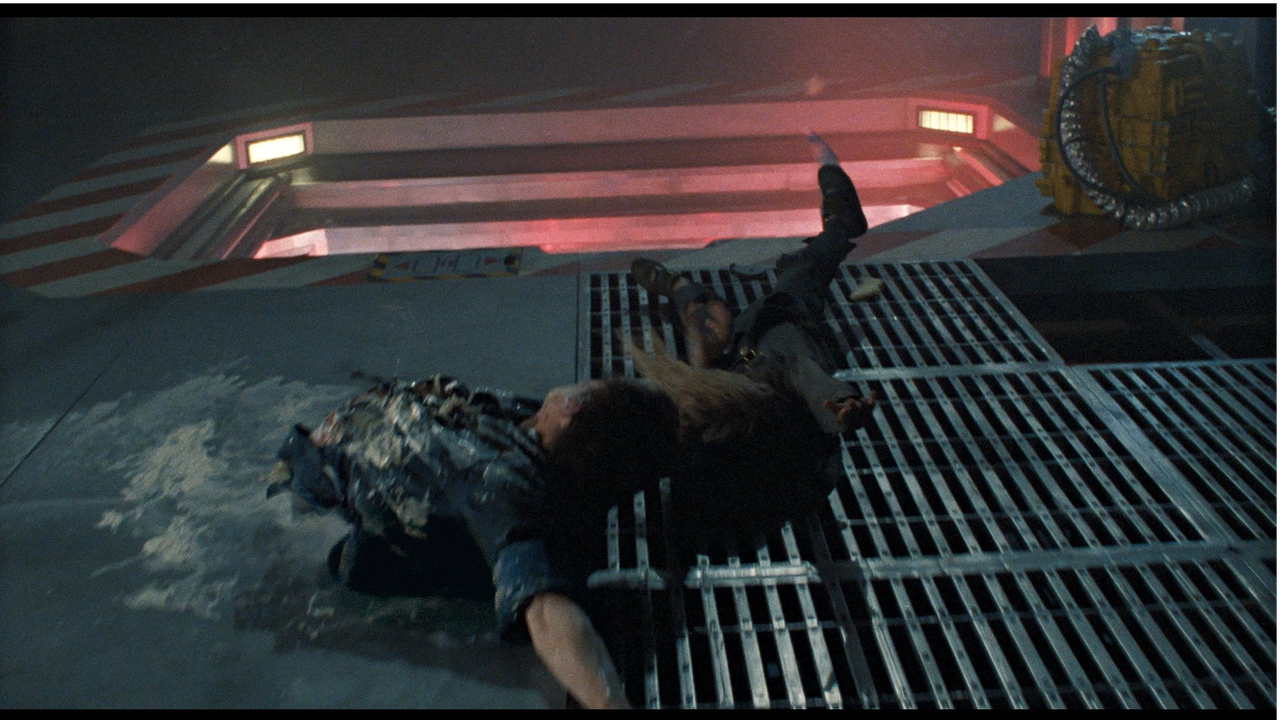

Ok so an update. Taking some advice from Doombot, I was researching how to do rotoscope in Adobe Effects to fix the hole under Bishop when I had an idea. I thought about Adobe Premiere and using layers and opacity. So I re-graded the HDTV broadcast to match the BD. I then layered them up. I turned down the opacity so I could match the frames spacial as much as possible, kind of in keeping with Andrea's advice. The HDTV broadcast is 1.77 vs the 1.85 of the BD, so the HDTV has more top and bottom picture whereas the BD had more info on the right (the HDTV was a little more stretched and wrapped too).
So once lined them up, I got the HDTV broadcast and carved out the area where the logo was and lowered the opacity to 0 so the lower layer of the BD came through. And it worked as long as the color regrade. This was the simplest fix since the area of the logo is in the same place all the time. Problem was I noticed all the imperfections of the HDTV broadcast. Not as sharp, lower bitrate, etc. So I decided to reverse the procedure and have the BD as the top layer and bleed in the HDTV part. Problem is unlike the logo, the area to cut keeps changing. So basically it was like old-school manual rotoscoping, I cut the scene into each frame and manually craved out the area to add the HDTV part.
It worked pretty well. Only problem was the HDTV was still a bit pixealted, so Doombot re-grained the HDTV for me, I did the process again and it seems to be a pretty good match:
[Image: %3E]
I even found a mistake in the BD footage. When the computer guy painted out the hole in the ground he didn't fix the lens flare in one frame. You can see in this pic the triangle cut out of the blue lens flare under Bishop's armpit:
BD/Fixed BD
[Image: bishop_compare.jpg]

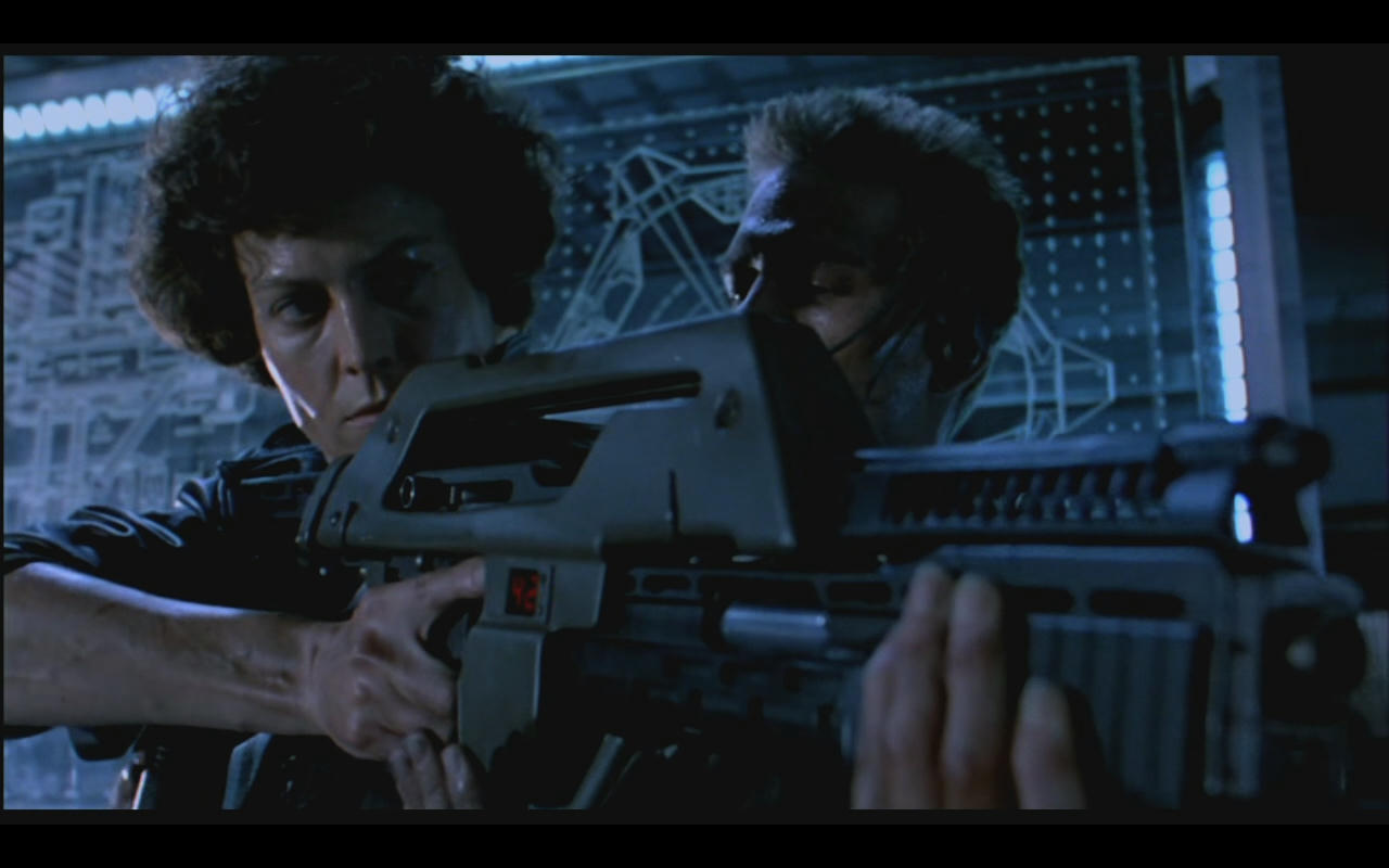

BD/BD regraded to 95 LD
[Image: alien_2b_comp.jpg]
#58
Just my two cents: now that I see those pictures, I remember that the laserdisc colors are almost always "pushed" to be colorful enough for the ancient CRT TV sets... just try to set the saturation at 75%, and let me know what do you think about the results...
#59
(2015-02-13, 04:47 PM)spoRv Wrote: Just my two cents: now that I see those pictures, I remember that the laserdisc colors are almost always "pushed" to be colorful enough for the ancient CRT TV sets... just try to set the saturation at 75%, and let me know what do you think about the results...
Good advice. Here is what it would look like at 75%
[Image: aliens_sat_change_2.jpg]
The blues are still very prominent but it does look more balanced.
#60
I like the early ones, but they are indeed a bit pushed. Could you try a middle point like 80% instead of 75%?
